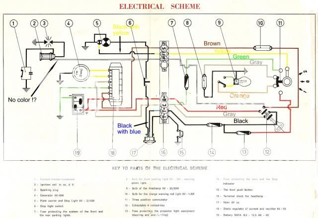

Here is the wiring diagram for your bike. You are looking for item #14 and it should be in the headlight bucket like Bob said.

CORRECTED Monza-type Wiring-diagram

" Here is the wiring diagram for your bike. "
____ That link takes ya to a copy of a diagram that's WRONG ! _ Everyone needs to stop copying THAT version ! ...
It indicates that the battery gets connected (through the ign.switch) to the ign.coil... That short-cut circuit causes the current-regulator to-be tricked (as if the load-system requires less power than it's actually consuming), and-so the battery then doesn't receive enough charging-juice and-thus becomes discharged !
Anyone who has ever wired-up their n-c.Monza/Sebring that way, has found that the battery/charging-system lets the lights go dim and the engine stall, after about an hour's ride !
__ I don't know where that INCORRECT-diagram originally came from,
but I've posted a correct-version without the mistake, below.

DewCatTea-Bob wrote:[quote= Moto Chuck ...
Enlightening-Cheers,
Sorry,
The fuse Octane needs is still between the switch and the junction block on both schematics and listed as #14 on both. I will make note of the correct diagram.
Chuck
