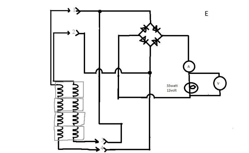

Mike,
now, if you add a diode in line on each lead right where the numbers are,(#1, #2, #3, #4) to isolate each of them, there's no short.
I think something else would have to be done at the rectifier?
I'll try to draw it later, I have to go to work now.
Bruce

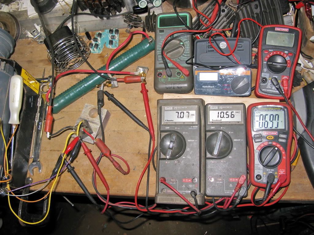

Up and running again, as I suspected the centripetal mechanism for the starter winding was in a pile at the bottom of the motor, luckily didn't take out any winding with it. I now have to pull start it to get 3450 but no big deal.
You're all very fortunate to get this today as it *was* the first nice sunny day in a while and I was planning to take the bike for a spin but now looks like thunder storms coming in.
1ohm load 3450 rpm, 7.1a, 10.6vac, 6.9vdc
4ohm load 3450 rpm, 2.9a, 15.4vac, 11.9vdc
5ohm load, 3450 rpm, 2.4a 15.8vac, 12.2vdc
7 ohm load, 3450 rpm, 1.8a, 16vdc, 12.7vdc

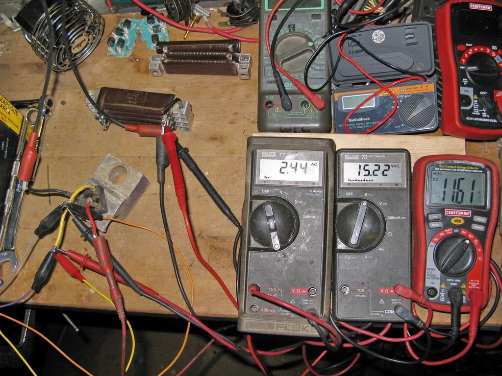

wcorey wrote:Up and running again, as I suspected the centripetal mechanism for the starter winding was in a pile at the bottom of the motor, luckily didn't take out any winding with it. I now have to pull start it to get 3450 but no big deal.
3 ohm load, 3450 rpm, 2.9a, 15.2vac, 11.6vdc (Just realized looking at the pic the current is reading on ac, took another spin on dc and revised the figure but didn't take another corrected pic.)
Thanks Bill, you are the champ.
In this setup the stator halves are operating in true parallel. common voltage but circuit current is the result of adding the current through the stators, so each half is lighter loaded. My thought was that with each half splitting the current load, that we might see the output voltage be higher. At any rate, each stator half is working less than if getting your output from one coil. I know goes without saying.
If you get to it, I'd be curious to see the same circuit at the same rpm with different ohmic loads.

The two standard output wires from the stator (1 and 2) are the black cord , with a black and a white conductor.
The added wires (3 and 4, formerly grounded to the stator core when in stock form) are the yellow ones (one has a black stripe). (all coming out of the alternator at 8 o'clock and draped over the grey motor)
The other end of the black wire (through it's set of coils/windings) is yellow/black.
The white wire (coil/winding set) has the plain yellow on it's other end.
(since 1,2,3 and 4 aren't color coded on the drawing, the two pairs are interchangeable in my descriptions)
The black wire has an orange jumper connection,
the white has a yellow jumper,
the yellow has grey
and the black/yellow has purple.
In summary, the orange and purple are two opposite ends of one set of windings, yellow and grey are the other set.
When looking at the photo's, it should be possible to determine the stator wiring scheme by the colors and placement, as well as the test data results by the meter outputs.

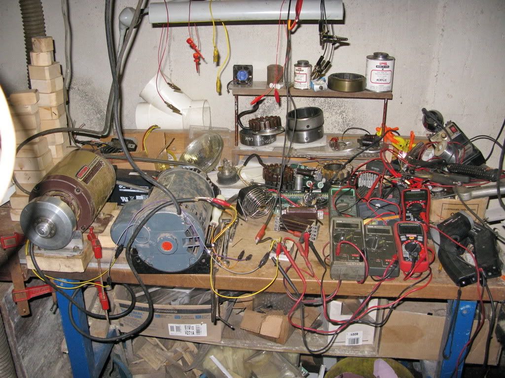

It may even be possible to determine rpm by whether or not the belt can be seen on the grey motor (top left in most pics), belt on, 6k rpm, belt off, 3450 rpm.
Loads are tougher, as the resistor values and connection scheme can't be seen, the big green one is 1 ohm and the stack of 4 flat brown ones is 3 ohm.
Values reported are rounded to the nearest single decimal point.
