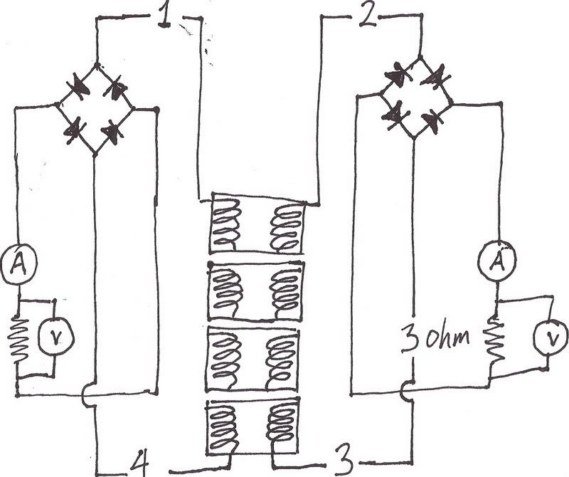

By: ecurbruce...
" I wish drawing were larger. "
____ Your drawing is fine enough Bruce, it can be clicked-on to enlarge !
" I hope this makes sense to you guys "
____ It's obvious Bruce, that you've figured where these testing-steps were heading towards.

ecurbruce wrote:here's a test that I think will tell if there is flux field interaction or show the effect of counter electromotive force.
This would be a test of simultanous isolated series circuits. Alternator windings with leads 2 and 3 would be wired setup like Mike's drawing "c", with a (with a 1 ohm resistor instead of light bulb,)
Then at the same time alternator windings with leads 1 and 4 also would be setup like Mike's drawing "c" , run to a separate rectifier and 1ohm resistor.
When spinning at 34oo rpm, if there is no change in the specifications (8.4 amps, 12.2vac, 9.2 vdc) from the previous test of one set of windings (Mike's drawing "c"), that would indicate the absence of flux field interaction effect. If there is a change in the specifications, it would indicate flux field interaction .
disregard the 3 ohm resistor in the drawing, it should be 1 ohm. I was lucky to get what I did in there! I wish drawing were larger.
I hope this makes sense to you guys with more "official and organized" training than myself, it's hard for me to explain these ideas without the professional jargon.
good job Bruce. check your diode polarities, I think you got some backwards.
that will be the interesting test. I think that I know what will happen, but the unexpected results thus far have given me pause. If there is a change then the question is pretty surely answered. but if there is not, how do we account for the change in the series connected stator when loaded?

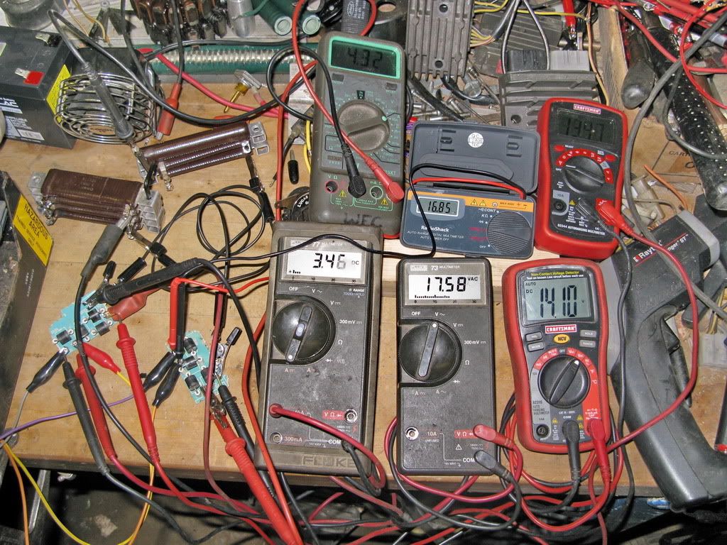

First come, first served...
Scrounging can be an art. Sorry about the mess, pretty tough to follow, but you can get the general idea. Wasn't planning on doing this one so soon but good to get it over with, lol.
Anyone wanting any variations on this, now is the time...
'One side' 1 ohm load, 3450 rpm, 4.2a, 7vac, 4.8vdc
'The other side', same load/rpm, 4.3a, 7.2 vac, 4.9.vdc
'One side' 3 ohm load, 6k rpm, 4.3a, 16.8 vac, 13.5vdc
'The other side', same load/rpm, 3.5a, 17.6vac, 14.1vdc
Hit a little bump in the road... While up at 6k rpm something made a 'bad noise', :shock:, we who play with motors all know the type of sound. At first I though it was the alternator but thankfully it turned out to be the driven motor, it has ceased to function. Guess it didn't appreciate life in the fast lane, no surprise really, it's what happens when you push things well past what they're designed to do. It was a mickey mouse setup anyway, was kind of a nice motor though, 'borrowed ' it from my jointer.
Lucky to get the data from the run at least. Guess I'll have to do what I really wanted to avoid and take the time to make a dedicated arbor to spin the rotor. Haven't investigated or thought about what that will entail, not up for dealing with it at the moment.
I have some still 'unpublished' data that I can post up in the meantime and you guys can ruminate on what we have so far...

" 'One side' 1 ohm load, 3450 rpm, 4.2a, 7vac, 4.8vdc
'The other side', same load/rpm, 4.3a, 7.2 vac, 4.9.vdc "
____ That's about 20-watts on one side and 21-watts on the other, (so 41w.DC total power-juice available for charging the [modified]- system).
" 'One side' 3 ohm load, 6k rpm, 4.3a, 16.8 vac, 13.5vdc
'The other side', same load/rpm, 3.5a, 17.6vac, 14.1vdc "
____ That's about 58-watts on one side and near 49.5 on the other, (so near 107.5w.DC total available power-juice for charging the modified system, [with the dual FW.rectifier set-up].

" If there is a change then the question is pretty surely answered. but if there is not, how do we account for the change in the series connected stator when loaded? "
____ I've already been thinking about that Mike,, but have held-back, waiting for test-results.
I'm thinking the low 1-ohm load-resistance is TOO low, thus making the alt.windings themselves act as a significant part of the total load-impedance.
" I would be curious about the following. "
Image[/quote]
____ Mike, after just a quick look at your hook-up scheme, it seemed fairly clear that it MAY contain a short-circuit, (depending on the actual polarity of the two stator-windings relative to each other.) ...
Your presented scheme could be bad in a specific manor. ...
__ If we think of the two stator-windings as D-cells both setting upright, then they will feed the obvious short-circuit (rather than go-through the load at all),, and if ONE cell is up-side-down, then the two cells will be in a combo parallel/series circuit-arrangement, both feeding the load together.
(So there's a 50% chance that such a D-cell circuit-arrangement could simply short-out.)
However the no-load voltage-measurements seem to indicate that the two stator-windings are arranged so as to avoid the short-circuit circuit possibility.
____ Just observational notes.
