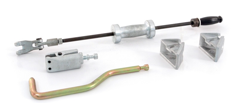

2nd step: the lower and upper bevel shafts are coupled by corresponding flats, facing to each other and held together/in place by sleeve 0400.29.173. The inner surface of this piece ist precisely ground for minimum free play of both coupled shaft ends, which's outer dia's are also precisely ground. The coupling can beseized due to corrosion, ore a previous owner has mounted a sleeve 0400.29.174, which has an undersize bore.
Imho, the only way to get the upper shaft free, togehtehr with the sleeve, is the application of an impact hammer, which pulls the parts off the seizure.
The best photo I could pick from the web:
Of course, you have to make a special adapter by yourself, which grasps under the sleeves flange on both sides, and also connects to the hammer's shaft. A protective shim or ring should be placed between the lower face of the bevel gear and the sleeve's flange in order to protect the protruding circular ridge.
