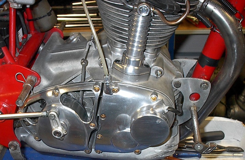

If you are really good with a milling machine, here's the kind of stuff you could try to lighten the engine.
This is a Vicky Smith picture and I don't have permission so I won't leave it posted here long....

Or a drill and some files?

JimF wrote:If you are really good with a milling machine, here's the kind of stuff you could try to lighten the engine.
(remove the pic if you want)
Exactly what I'm looking to do -- lightened, external oil lines and other crazy stuff. I have the mill/lathes and fabrication equipment. Just one engine -- all others will be restored or mild race setup.
I'll ask Vicky when she is back from WDW2012. She knows the chassis that this engine will go into. She has wanted me to bring it to Barber upcoming -- just never had time last year to go through all the old parts or finish the chassis and new coachwork. Daily business is more important at times.
Thanks!
More details from the same bike, no surprise Rich Lambrechts of DesmoPro did the work. He put the bike together for the 2007 Motogiro d'Italia IIRC.
