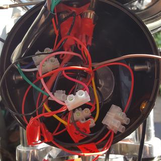

No, sadly it wouldn't start at all! The spark had gone AWOL, the fault was eventually traced to a crimp terminal on the coil, only it wasn't, crimped that is, or at least not properly. Needed to take the tank off to find it. Glad in a way it happened now and not alongside the road someplace. But once fixed, yes, starting was a whole lot easier.
However if one crimp can fall out how long before it happens again? I think a complete rewire is required, look at the photo and you will understand why.

Hi Jack,
I think we all have had a headlight bowl that looked like that at some time or other, colour coding seems to have been deemed unneeded on this job :roll: , never mind those terrible connector blocks (I hate those) If it were me I would definitely rewire, even just for the peace mind that comes from actually knowing the jobs good and the bike won't die somewhere from a dodgy wiring system.

Aye John, a veritable 'rats nest'! :evil:
I agree that a complete re-wire, with modern 'thin wall' cable and properly soldered and crimped connectors, with insulation and or heat shrink insulation to protect the connections and twist wrap sleeving to keep it all tidy is the solution.

Nothing of the machine's original wiring, switches or lights had survived everything had been replaced. Of the wiring that was there, it's all gone now, having been rewired without those horrible "chocolate-block" connectors. Kept it nice and simple, switch by the front of the saddle, 1, lights 2, off 3, lights and ignition. For the lights a DPDT centre off switch, one way pilot and rear light. other way head light and rear. There was an electronic regulator already fitted which I kept, but did move it out of the tool box to somewhere where it would get some air flow over it. Also there was an electronic ignition box which I also kept, however it has a number different advance curves selected by a switch, no idea which one to use. I will ask about that in a separate post. It does tend to kick back when starting so probably not using the right one
