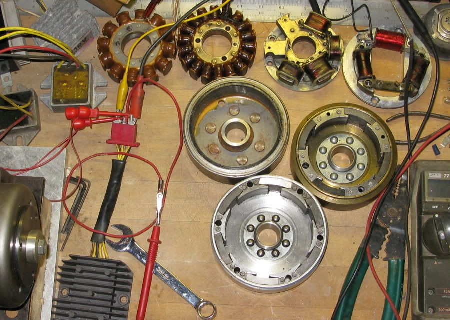

Could you please (sometime) post a picture of that Suzuki-rotor showing it's inner-side with it's 12-magnets ?
The newer type rotor's don't have the same sort of magnet arrangement as the Ducati singles, you cant obviously see them on some unless there is some ferrous debris sticking to it to form a pattern. The way I tell is to run a steel tool along it and count the areas of attraction. The Singles rotors use that principle of the magnet sandwiched between two metal plates to 'intensify the attraction'.
With the newer ones the magnets are very thin and it seems as though the magnets are directly adjacent to each other and apparently have enough force from the magnet alone to do the job. Don't really know for sure because I can't see 'em. When the stator gets sucked into that ZX14 rotor you need tools to push it back out, the thing is strong...
Don't have a good pic of the Suzuki rotor taken/photobucketed but this should give you the idea...
On some, such as the much more recent gsxr and zx rotors there are flats or other cues you can count.
...to make it rotate/work physically along with the Ducati-stator, then I can't understand why you'd not get any output from that ('shotgun-wedded') pair.
All I know is that I get no measurable output from any Duke/Denso combination, I still believe it's to do with the large width of the magnets on the singles rotors overlapping too many at once of the more densely coil populated modern stators. Maybe also the tight spacing of the magnets on the Denso rotors with the singles spread out coil arrangement, one coil hits an opposite/same pole where there should be just a space, canceling something out, though that's even more speculative on my part. Outa' my depth here...

" The newer type rotor's don't have the same sort of magnet arrangement as the Ducati singles,
With the newer ones the magnets are very thin and it seems as though the magnets are directly adjacent to each other and apparently have enough force from the magnet alone to do the job. '
____ Okay, with that clue & the picture of the modern-type rotor, it's now pretty-clear to me as to why the outcome of your testing (with the functionally mismatched stator & rotor) not only didn't have any output but was completely 'zero' at that ! ...
Due to the lack of proper space between opposite pole magnets, ALL of the 6 poles of the stator are exposed to the exact-same magnetic-pole at the same time, instead of every-other stator-pole (as must occur in order to induce current within the coil-windings!).
Ducati's (6, large) magnets have N & S poles at their ends and are every-other oppositely arranged so as to polarize the rotor's 6 poles with 3 North & 3 South polarities.
I had (wrongfully) assumed (without thinking) that a rotor with 12-magnets would merely double the number of N & S poles and (seemingly thus) simply double the number of power-pulses per revolution of the rotor, (as would seem to naturally stand-to-reason).
However in order to keep every-other stator-pole matched to an opposite polarity, ya have to maintain a number of magnetic-poles that's an 'odd' (rather than 'even' -[such as '12']), multiple of the number of stator-poles !
Therefore if ya have a stator with 4 poles (for example), then the rotor (matched with it) needs to have an odd-multiple like 1x or 3x or 5x (etc.) as many magnetic-poles, thus 4 or 12 or 20 magnets in the rotor would work (with the 4-pole stator), but even-multiples such as 8 (2x), or 16 (4x) would not provide the required alternated polarity-arrangement !
(I knew of this particular fact before [when posting within the other thread], I just stupidly didn't think of it when I mentioned wcorey's related project. [But if I hadn't made that screw-up, we then wouldn't have gotten him back with all this neat food for thought!].)
__ So anyhow, in the case of the 6-pole stator, we could have either 6 or 18 magnetic-poles in the rotor,, but now we understand why the "12 " doesn't work !

____ I think if you tried using a small magnetic-compass, you could move it within a circle within the rotor, so as to point-out the boundaries of each of the magnets.
" All I know is that I get no measurable output from any Duke/Denso combination, I still believe it's to do with the large width of the magnets on the singles rotors overlapping too many at once of the more densely coil populated modern stators."
____ In this opposite/reversed situation - (with a Ducati 6-pole rotor over a modern multi-phase stator), this arrangement of having just one magnetic-pole (of a rotor) covering 2 or more stator-poles at a time,, may or may not properly work-out, DEPENDING on the circuit set-up of the coil-windings of the neighboring stator-poles !
__ In these cases where you found zero output, the neighboring stator-poles probably were particularly coil-circuited so as to only be used with an equal (or greater) number of magnetic-poles.
Cuz it's actually possible for 12 (evenly spaced) stator-poles to be coil-circuited so as to work with just 4 magnetic-poles (or even only 2 rotor-poles, if single magnets could be stretched far enough) !
