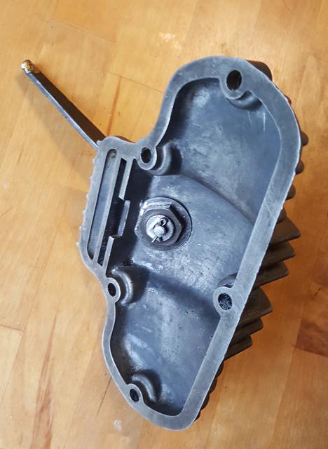

Rolling the bike back in gear, yes that would do the trick, just one problem, I haven't quite mastered the trick of kick starting with my left leg (to many years of riding British bikes with starter on the right). May have to learn how to do it, but in the mean time, my efforts find a valve lifter have come back negative so far, I thought I would try and fabricate one, The photo showed my attempts so far.
Not finished yet, I will report back on how I get on.

A bit more work on the home fabricated valve lifter showing the now much shorten pin and the home made tab washer cut from sheet steel.
Need the to braze something on the end of the actuating arm to act as a termination for the bowden cable but have run out of gas (O2) work on hold for the moment.

The homemade valve-lifter in place, Not the most elegant of devices perhaps, but it works.
A slightly stronger spring under the operating pin and some tiding up no doubt needed, but getting there.
Big thank you to "themoudie" for help and advice.
