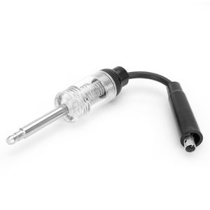

Poor Running and backfires in the exhaust are usually caused by intermittent ignition. This can be from oiled ,dirty points ,gap closed up ,bad connections, dirty plug etc etc. it can also be the case that there is no ignition fault except dirty plug from carb or oiling up problems.Start with a new plug laid on the head, turn the motor till the points are closed, flick the points open with your fingernail ,you should see a BLUE spark at the plug and a spark for every flick as fast as you like. A red spark is no good. This test assumes you have battery ignition and a charged battery. If you do this test in the dark it will be easier.A dirty plug does not always mean you have oil or carb issues, it can come from bad ignition. Thats why its best to start with a good regular spark.If you have the orriginal no battery system then either change to a battery system or polish the bike and mount it in the lounge!.

Thanks Bob, sounds easy enough. The bike is a Monza, so 'yes' to the battery question. My newer battery is fully (trickle) charged, my spark plug is brand new (clean) and the coil is new, but the lead from the coil is probably original. I have installed a plug tester to verify I am getting a spark when kicked, but never operated the points arm manually. I have a plug tester like the one below, not sure I can get to it tonight, but will attack it tomorrow. Actually, a great thought, thanks for sharing.
I will order a new lead, at a minimum it's fifty years old.
