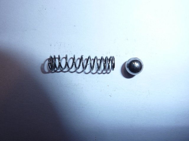

Oil pump question please,
The spring and ball for oil pressure relief isn't in the oil pump I am cleaning up.
There is a bag with small springs and balls, not sure they are for the oil pump or God knows what ?
The parts manual online says the ball is 1/4" (6.35)
But doesn't give the spring dimension.
The spring I have is just under 12mm uncompressed x 5mm diameter
Anyone have an oil pump apart at present ?

I think the spring and ball I have may be from the kick start fold out lever.
The ball is 4.73mm . It is not 1/4 (6.35 as the manual says.
Still if someone has an oil pump apart can I please get the oil pump spring dimensions

Hi Graeme
These measurements are from two pumps from 1959 200cc Italian engines. Both giving the same dimensions, which would indicate they are the original items.
Bear in mind the springs have been compressed for sixty plus years.
BALL 1/4" Diameter, Spring free length, 22.5 mm long, 5.5mm Diameter, .5 mm Diameter Wire, 12 Turns.

Thank you very much Brian
That’s fantastic
