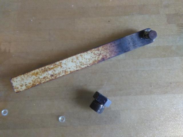

Then there was that slipping clutch, as advised here I thought I would strip out the plates , inspect, clean or replace as required. Only I couldn't get the cover off! Or more properly couldn't undo the 6mm allen screws or the 22mm plug in the centre of the case. Firstly the plug, this has a 14mm hexagonal socket in it, but didn't have a key that big, so I made a tool to do it by modifying a bolt so as it was a nice tight fit in the plug and then brazed on to short piece of bar, Crude I know but it worked however not until an extra two foot of tube was slid over the end of the bar. Did it really need to be that tight? And then, there were the 6mm allen bolts around the outer edge of the cover, I did have a key for those but even with the two foot tube they wouldn't come out either. Whatever are people thinking about? Got them out in the end using ratchet torque gun and even that had to be set at 200n/m before they would let go.
Home made tool to get the centre plug out and a 22x1.5mm adapter for the extractor.
I am amazed that so fine a thread (1.0mm) didn't strip out of the aluminium crank cases when done up so tight. To be continued ........

The brass plug is removable to fit a timing tool to the crank end and should have a copper or alloy sealing washer like a sump plug.

No, not at all. As advised by Graeme, it should have a copper sealing washer underneath it, and be done up tight enuf to compress the washer and stay oil tight - and no more.

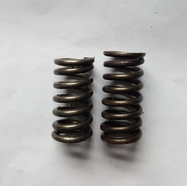

made years ago from a piece of half inch rod threaded BSW at the end, an odd bit of 25mm hexagon that I had about the workshop was popped in the lathe, turned to size, drilled and taped to fit the rod and thread cut to 1.5mm pitch. Screwed in to the cover with the slide hammer attached and with every thing clear the cover came off no trouble. The screws holding the clutch springs in place were a little "chewed" in their slots but not enough so much as to prevent them coming out with a normal screwdriver. Oddly despite them being screwed as far they would go, there was little or no resistance to undoing them.
Compared with the springs given to me with bike they were just over 3mm shorter! The cause of my problem perhaps, I will however check and clean the plates before I put them back. I did think the clutch was very light before.

You appear to have found the culprits. ;)
"Oddly despite them being screwed as far they would go, there was little or no resistance to undoing them." That is how the screws are supposed to be.
