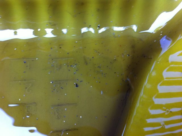

Hi Bob, no signs of fuel in the oil. Just metal. Enough to paint a Silver Shotgun!
The oil was maybe 500ks old, the level was normal and looked and smelt like 500km old oil.

" no signs of fuel in the oil. Just metal. Enough to paint a Silver Shotgun! "
____ Okay, then in that case, it seems that it wasn't the piston-damage that led to the crank-pin failure.
__ So now I wonder how your PREVIOUS batch of dumped/used sump-oil appeared to be ! _ Did IT also show any signs at all of any metallic-flakes disbursed throughout it, as well ?
Cuz if so (to any degree), then I'm now suspecting that you possibly had/have a motor-case ball-bearing that's gone/going to pot. _ As the ground-up (and much harder) particles from such bearing-failure could've been the root-cause of the damage to BOTH the piston and your crank-pin.

No signs of sparkly bits in the previous oil change.
I try and let drained oil sit for a while to let any "bits" settle so I can see them when the oil is poured out, there were none.
All the bearings and bushes will be replaced.
I've just dismantled the head and washed it out, lots of sparkles but all very small.
Graeme

Here is the oil drained from the engine (it was cold) not hot as per a usual oil change.
Below is what washed out of the split cases, some small bits of gasket are there too.
Below is what came out of the sludge trap, there is a long magnet with shiney bits attached.
Below is what washed out of the 2 crank halves and the stripped oil pump.
There's more metal than what came from the failed crank pin, some is alloy and some is from the crank end (oil pump end) and some will no doubt be other bearing material.
There were no usual rumblings from the crank pin and bearing to warn of impending wallet torture like I've heard in the past from big end or main failure. (I've never had a big end fail before, but heard them)
By the time it made itself known the damage was done.
I'll endevour to fit magnets in the future to all my singles. (2)
A friend in Ireland showed me a Magnom inline filter, and a magnetic strainer in place of the standard gause filter that are worth considering.
Anyone else have any suggestions?

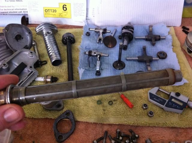

Oil-filtering
" There's more metal than what came from the failed crank pin, some is alloy and some is from the crank end (oil pump end) and some will no doubt be other bearing material.
Anyone else have any suggestions? "
____ You had mentioned also finding same up-within your cyl.head...
So if any of those particles up in there were also as large, then I'll bet your oil-filter/screen-tube was warped ! ...
A common-problem with that filter/screen-tube/drain-plug is that when it's reinserted back-into place in the crankcase, it's nose/tip-end doesn't always simply fall-home & into it's intended place (inside the oil-pump's inlet-hole), thus allowing unfiltered oil to enter into the oil-pump.
__ I've already warned of this possibility before, that if ya'r plastic screen-tube doesn't appear to be nice & straight (when removed), then it was likely (at-least at some time in it's life), inserted & tightened-down without proper care (and forced to become warped). ...
When the screen-tube is inserted all the way in (properly), it should be able to be screwed-inward by hand ALL THE WAY in, (with a wrench only needed for just the last half-turn) !
However if the screen-tube's threads only screw-in about half-way when some resistance is then encountered, then that means that the tube's tip-end/nose is not entering into it's place in the oil-pump's inlet-hole !
So at that point (of encountered resistance), (if it indeed happens to occur), the screen-tube's threaded-plug end should be twisted back & forth and finessed until ya feel the resistance get pressed-away, and thus-then it's nose-tip has been successfully inserted into it's expected normal-location/place inside the pump's inlet-hole (and not forced to become warped-up into a crammed-space).
__ So do you have a picture of your oil screen-tube for us to have a look at ?

Tomorrow, it wasn't the strainers fault, the particles in the oil pump and downstream were all small.
