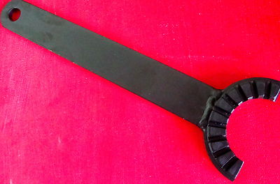

As I am about to start putting together a '70 350 Mark 3, are there any "must have" tools I should acquire?

1. Exhaust nut spanner. Various models, but this is the original design. Do NOT try using anything else.
